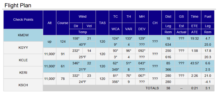

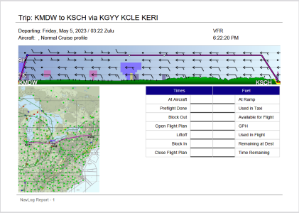

As it happens, I still have iFly EFB on my iPad, so I made up a flight plan from MDW to SCH, and printed out the nav log.
I've attached the .pdf, if anyone wants to see what it looks like. As with most .pdf's you can specify which pages you want to print.
Edit: .pdf, and zipped .pdf both too large to upload. I'll try screenshots.

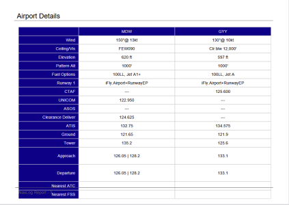

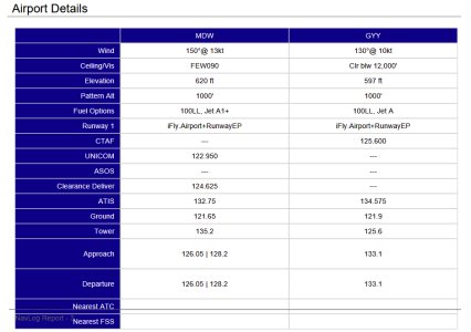

There's Airport details for each airport waypoint I had.

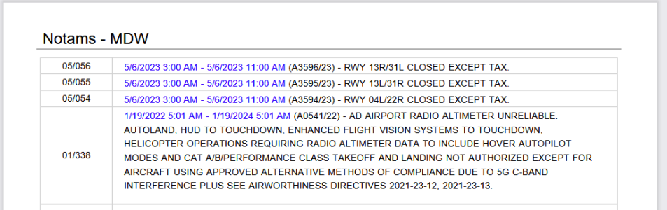

Then seven pages of NOTAM's

I'm just looking at that printed FP page and thinking, "If the screenshot had too much gobbledegook on it, how is this one better?" 🤷🏻‍♂️

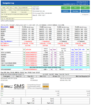

If I print anything out when I fly, it's this. I'm sure it wouldn't be helpful for your wife, but as a pilot, I don't see anything in MDreger's 10 pages that I wish I had that isn't on this single page, and when I print "2 sheets to a page", it comes out perfectly sized for a kneepad (I can fit four flights on a single piece of paper):

Zowie! Cobra, I've just glowered at your printout for a long time--maybe a minute or two so far--without yet getting oriented to it. It's soooo dense! Where to start?! (That's a rhetorical question only--because right now I don't want to be given a key to unlock it.)
MDreger's early-EFB printout, on the other hand, is if anything too easy. It begins with pictures and then goes on to add text to describe the pictures and apply them to flying an aircraft through the space they depict.
I can't think of two more different descriptions--that is, logs, or more accurately, predictions--of flying from A to B.
My feeling is that for yours, a pilot would probably want considerable experience in flying IFR before starting the engine for this trip. MDreger's pilot can be a beginner on a discovery flight or at any other experience level.
You pilot is not likely to be navigating by pilotage. MDreger's can do it either way.
That's not to say I think printing out seven pages of NOTAMS is sensible. There's definitely need for a STOP THAT!!! switch. There's plenty of room for improvement in that art deco EFB's flight plan and printout.
By analogy, what we have here is glass panel flying versus art deco's Minimum Equipment List flying.

I've been using these since I got my PPL. If it took me any time to get used to them back then, I don't recall it being a struggle. Fltplan.com has been around for a long time and has quite a large user base, so apparently some folks like it.
Yes, this printout is dense--that's how you get a lot of info on one page. Different strokes for different folks, I suppose. I don't use every bit of data on the page, but the stuff I don't use doesn't bother me being there. I just focus on the bits that are most important to me.
For flights I make repeatedly, it takes me about 3 minutes to file a flight plan, and I can do it from my phone. Unfamiliar flights might take me 5-7 minutes.
IFly would have to come a long way to match what fltplan.com does for me re: flight planning, VFR or IFR.

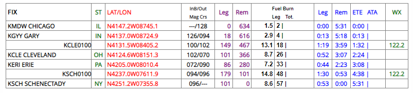

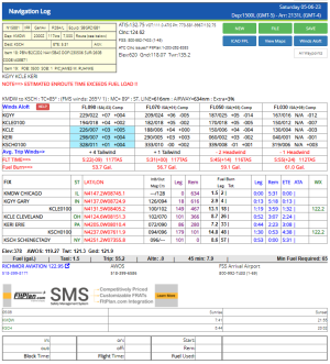

For an apples-to-apples comparison, see below for MDreger's flight plan as shown by fltplan.com.
A few things to note:
  • I am warned at the top IN ALL CAPS RED TEXT that this flight exceeds my fuel capacity.
  • Two legs are long enough that FP.com inserts additional waypoints.
    • The 249 mi leg between KGYY and KCLE gets an intermediate waypoint 100 mi out from KCLE
    • The 280 mi leg between KERI and KSCH gets an intermediate waypoint 100 mi out from KSCH
    • This is mostly important from a legacy standpoint, but would still apply to anyone flying by pilotage without electronic navaids. You can see that over those long legs, the magnetic course actually changes rather substantially. The intermediate waypoints include updated magnetic course numbers to help keep you on track.
      • Note how when you pass the KGYY waypoint, your outbound magnetic course is 094, but when you arrive at KCLE, it's 102
      • Similarly, when you depart the KERI waypoint, your magnetic course is 090, but by the time you arrive at KSCH, it's 096.
  • With ADSB-in, the winds information is not so important anymore, but that was extremely handy in the days before ADSB-in. I look at that info pre-flight to help pick my cruise altitude(s), but in practice I don't look at it during flight, unless I can't get wind data via ADSB.
    • One thing that's handy in that section is at-a-glance cautions about potential icing conditions. That's what the blue highlighting is indicating in the FL090 column from KCLE to KSCH.
  • I don't use the LAT/LON data and my eyes just skip right over it.
  • I like having the comm frequencies for my departure and arrival airports handy. They take up a lot less space on this printout than on MDreger's, making them handier.
    • In practice, I often get those from iFly or my in-panel GPS navigator, but it's nice to have it on paper just in case. and I sometimes grab a freq there anyway just because I don't have to tap anything to get it. I do routinely use this info at the beginning of an IFR flight if I want to check weather or call Clearance before starting the engine and getting all my electronics up.
    • FP.com's page includes the FBOs on the field, including freqs and phone numbers. I've had flights where I couldn't remember the name of my FBO when I landed and would have cluttered up the Ground comm with my confusion, but a quick glance at the sheet got me straightened out. I've also referenced the page on ground/off-airport to get the FBO phone number.
One thing that MDreger's printout has that fltplan.com's doesn't is the block of TC/TH/MH/WCA/VAR/DEV. That would have been nice during my PPL training. With modern equipment, that's less important today though, and I haven't missed that info during my flying. I can see that being valuable to others, though.

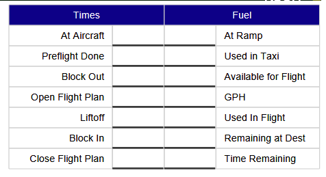

These are the components I'd like to be able to print out for the clipboard and/or paste in to my tablet for the pilot's use: (completely open on the format and layout).
although I like the format below a lot - very clean and simple. Seems like the main thing missing is cruise altitudes:

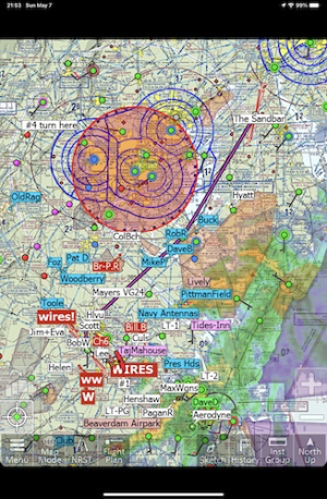

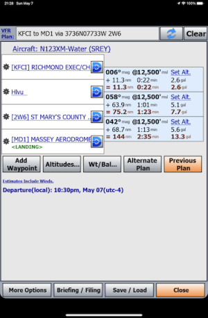

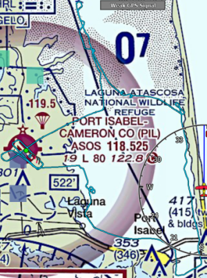

All right, here's a relatively simple VFR trip I made recently that illustrates some of the things to consider when flying in the Mid-Atlantic. First, the map:
It's from KFCI (paved, untowered) to MD1 (Massey Aerodrome, turf), my first time there. Along the way there's the ugly DC thing and lots of Restricted areas. And the Chesapeake Bay and PAX River NAS. The winds and times in the printout below are the defaults for the time I made the screenshot. When I made the trip, the wind was from the SW, so I cruised at 12,500 and came back later in the day at "1,000" feet, but most of that was at 500 feet and lower still over the Bay.
I printed out the screenshots for my wife--the Altitude screen, too, which she seems to find comfort in. Then I printed a second copy of the navlog for myself. I used the space at the bottom to draw a schematic of the destination field--just a line for the runway, with the numbers at the ends, and the CTAF, 122.9. I even drew an arrow for my probable approach direction. I've been doing that for unfamiliar airfields since I was a student pilot and find it helps me considerably with situational awareness. Sure, the GPS has that and more; but the act of drawing it with a pen or pencil helps to keep my head on straight. That little diagram is the same, regardless of the devices I'm using for navigation. If I don't print a navlog, I still make the drawing.
My wife and I had PAX River jam the GPS signal once, just as we were in the middle of the Bay. Fortunately, I knew where we were and our heading to pass through the narrow gap between PAX River River R-4007 and the DC SFRA, so we just motored on, and the GPS came back up about 70 miles later. But it was a powerful lesson for me, and is the reason why I don't trust the electronic gizmos, not even iFly. I NEVER fly without some kind of paper help--part of a sectional from Skyvector and at the very least a hand-written navlog with courses, bearings, headings, and times.
The flight plan (navlog) printout usually seems to comfort my wife, even though she doesn't pay much attention to the right side of it. She wants to know where I'm going and what I'll pass along the way. She'd probably like more detail, but this much seems to be enough. I might add that she has flown with me on several long-ish SeaRey trips--to Florida, to the Georgian Bay in Canada, the Glenn Curtiss seaplane pilgrimage to Hammondsport, NY, and around the Mid-Atlantic area. She hasn't been able to get into the SeaRey for several years because of a bad hip, but she got a nice new titanium one a few weeks ago, and may be able to get back in the air eventually.
I filed a flight plan for this trip, but didn't activate it, because I preferred the liberty to deviate--which I did liberally--to the safety of talking to ATC. (I carry a satellite gizmo to summon help if necessary.)

Calculation errors?? Were you in the Beta version or Live Release when you got errors? What were they? So far, mine seem pretty accurate.
Hopefully the calculations on the flight plan table will be corrected before an official release occurs ;).
The errors in question were in the "original" iFly EFB effort that has since been terminated. You can see them if you scroll back and look at the example nav log posted by MDreger.
Since that particular effort has been overcome by events and is no longer being pursued, those erroneous nav logs are no longer a concern.
