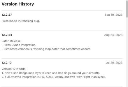

Mine was on my Android and there is a page on the Adventure Pilot Site with APK updates for Android that were not yet released into the Google Store so once I updated to that version, it cleared up. Clearly the problem is across platforms, the only thing I can reiterate is to be sure you have their latest version of IFly, which it seems you might have. This shows that it was included in their recent updates for IOS. It looks like version 12.2.24 included a fix that adressed this problem, and now they are up to 12.2.27. Hope you can figure it out. I discovered my issue when on a long cross country flight on my first trip from SoCal to Payson AZ. Like you and many others, I update everything on a regular basis, especially before a long flight, and it worked fine at home on an internet connected wifi, so it was a shock when I zoomed in to that level later in the flight and got that message. It would resolve itself if I connected to my phone as a hotspot and tried again. It only showed up when connected to a non-internet wifi...my Stratux. Kinda freaked me out.

I'm duplicating this symptom now on iFly EFB 12.3.3 -- and should have it fixed tonight for tomorrow's beta release. Looks like we might need to do an emergency patch release for all of our users, on 12.2.x
