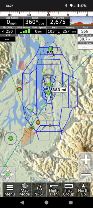

I prefer the vector view because it is easier to read, however I don't like that airspaces to do not show their altitudes like in the VFR view. For example, when I fly around Seattle/Tacoma I can see their airspace in vector view, but without altitudes it makes it unusable as I don't know if I will be in them.

My thought is that when I am flying around an airspace like this with about 17 different altitude airspaces, it would be nice to just be able to look at it. That would be a lot of clicking as I fly around the south side of it.

The thought is so that it would be quick and easy when glancing at the map to see if my altitude will cause an issue (my flights are always VFR).

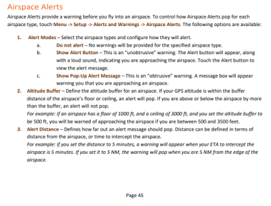

The iFly manual might be helpful for questions like this. It's on the iflyefb.com Support page, here: https://www.iflyefb.com/Support/Get-Help
A direct link to the manual is: https://www.iflyefb.com/pilotsguide
For this specific question, this is probably the info you're looking for:
Great feedback, thanks! Yes, I get what you mean about features of the vector view and each person has their own desires. Maybe at some point in the future this will be a selectable list like what I have on my Avidyne IFD440, where I can determine which items show up at which filter level.
And the tips on airspace alerts is exactly what I needed, thanks! That will satisfy any current need. And in reality if I do proper flight planning then I'll know all these airspaces and required altitudes before I ever leave the ground, and the alerts will help me if I get off course.
