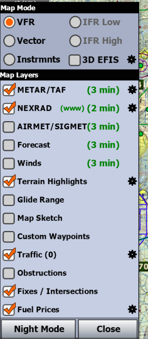

Any chance you're looking at the Vector Map? Click on the "Map Mode" button on the left side of the bottom row of buttons. A new menu box will open. At the top, make sure that VFR is selected.
