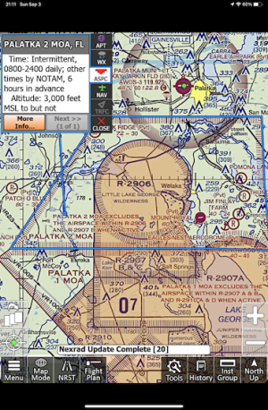

1) when I click on special use, such as a MOA, it does a nice job of highlighting the borders of the airspace, and I readily see the times and altitudes, and the more info expands to show the rest of the info box. It even tells me the controlling agency when I've tried it but does not always list a contact.
a) in the example case I'm looking at right now Palatka 2 MOA in florida, it says controlling agency FAA Jax ARTCC....but does not give me a contact freq.
b) clicking in R-2907A does say frequency 134. Is that supposed to be 134.000?
2) my second scenario: If tooling along VFR not talking with anybody....and decide to pick up flight following. Intuitively , I was thinking that if I click on the map in an area especially with no airport or navaid, OR if I click on my "present position" that it might show me the airspace and list some contact freqs. Is the area controlled by a center or an approach control? and in that area, what is the best contact freq for them? Maybe better even to also highlight the ATC Center's sector geography, so that I can see if I'm getting ready to leave an area, etc....

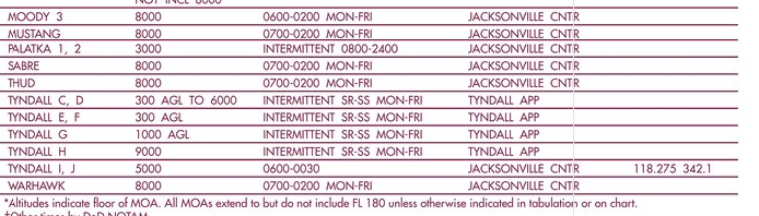

a) Pretty sure iFly gets it's info from the sectional data feed that is provided to them. I looked at the chart data for Palatka 2 MOA - it lists exactly the same info as iFly displays when I click on the MOA - no contact freq shown.

I supect that the Info box is truncating the info and that, maybe, what you're seeing--differs from what I see on my iPad MIni 6--is only part of what iFly has found.
I sent in a screenshot bug report, but it wouldn't do any harm for someone else to send one, too.
It is sometimes a two-step process:
1 - click on the SUA and then click on "More Info" to find the controlling agency. The frequency may be found in the "More Info" window (such as for Alert Areas... as an example, check the Alert Area to the east of the Palatka MOA: A-293). MOA's appear to be controlled by ARTCC for the sector... in the "More Info" window, it will name which ARTCC.
2 - I guess since the frequencies for an ARTCC may differ depending on where you are actually flying, click on the airport nearest to you and click on the "Airport Info..." button in the airport pop-up. Scroll down to the "Communications" section and locate "Nearest ATC" and the frequency will be listed. Using the Palatka MOA as an example, if you are flying to the SW of the MOA near OCF (Ocala INTL) the Jacksonville ARTCC frequency is listed as 135.75. However, if you are flying to the NE of the MOA near 28J (Palatka Muni) the Jacksonville ARTCC frequency is listed as 135.45.
It does appear that Restricted Areas are controlled by a mix of controlling agencies... some TRACON and some ARTCC. The ones around the Palatka MOAs list both. In either case, the frequencies for each are sometimes listed. The Restricted areas around the Palatka MOA do list frequencies for areas controlled by TRACONs and ARTCCs. However, the Restricted Areas to the north near 42J (Keystone Heights) don't list any frequencies, whether they are controlled by TRACONs or ARTCCs. I'm not sure what the margin notes of the Sectional covering this part of Florida show for these SUAs. Does AP capture the margin notes for Sectionals and if so, how would we read them? I know that a competitors product does and presents them as "documents" to the user. EDIT: I found kind of a version of sectional margin notes by clicking on the icon above the "Menu" button that looks like some stacked pages and then clicking on "Browse Map Legends...".

Just guessing, but I recon that it might be hard to parse the data for things like the MOA's that don't have the freq published in the map's legend table. I suppose the data needs to be published someplace in order to grab it...but at least if it came up listing the controlling agency and freq for that sector...be it either center or approach...at least you'd have a get to the point quick and easy contact
