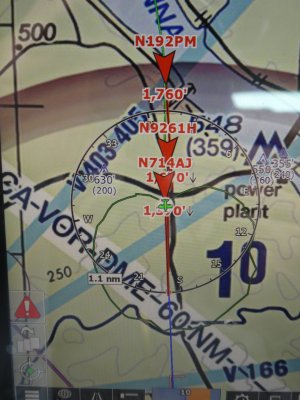

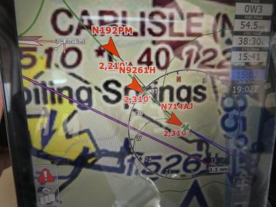

Greetings,
I recently updated by IFly EFB and noticed that the altitudes of all my targets truncated the altitude to the first 2-3 digits.
For example, when traffic formerly read "2,300" it now reads just "23."
I would like to GO BACK to the way it was as I fly low (about 1500 AGL for the most part), and have crop-dusters and helicopters below me and much traffic just above me -- so I appreciate the FULL altitude read out on my screen.
Is it still possible to have that displayed on my screen? See below for the way I prefer to have the traffic display on my screen.
Thank you in advance for any assistance! I did try to adjust it using the options offered, but so far no luck on my part.
Mike (long time user and loyal customer!)

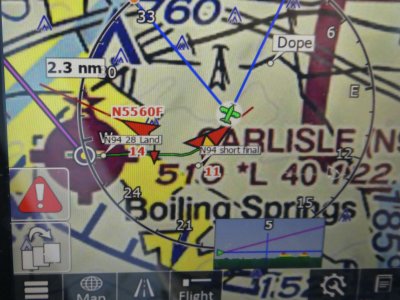

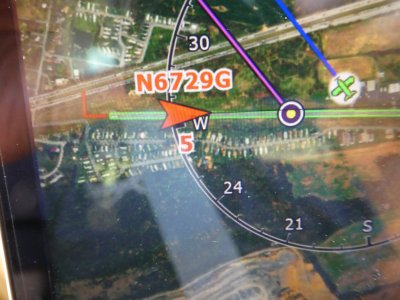

I tried turning OFF relative altitude and tried both INDICATED and GPS altitudes but still I cannot get the FULL READOUT of traffic altitude around me...so, instead of getting 1,500, I get 15.
How is this a flight safety problem for me?
I fly LOW, around 1,000 to 1,500 feet AGL and I have MUCH traffic under me with crop dusters and helos...I would strongly prefer the FULL readout.
I cannot get it to go back to the way I liked it and worked for me to avoid traffic as I fly in a HIGH traffic area.
Thanks - Mike
Photo 1 and 2 = what I want to see
Photo 3 and 4 = what I am getting and do NOT prefer
Please help - thank you.
Mike
