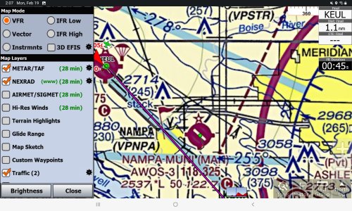

The NEXRAD and Weather data is 28 minutes old.

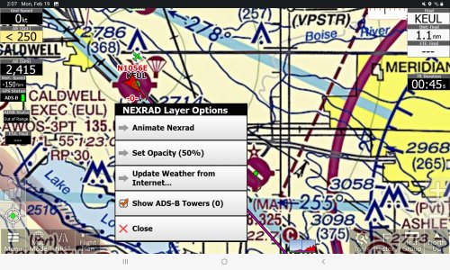

I want something more recent, so I update it

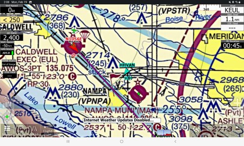

Immediately after I push this button, I receive this message:
Note the "Internet Weather Updates Disabled" message.

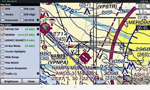

After some period of time, however, I note that it has updated the data anyhow:

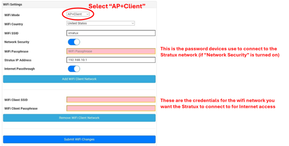

The current versions of Stratux firmware allow pass-through Internet access without a second NIC or any other additional network components. It's just built in to the setting page. I use this at home to maintain access to the Internet when I'm testing devices connected to the Stratux, and in the plane with my phone's hotspot. Works great.

Sorry; my original post was not clear. I do not switch between environments. I have two Strratux devices--one in my plane, and one at home. I do not move a single Stratux between different locations/networks. However, if I did, I think the Stratux setup page allows you to define login credentials for multiple networks (see the "Add WiFi Client Network" button):

3. On the IFlyEFB screen, do you get the "Internet Weather Updates Disabled" message?
Yes, I have observed the strange/incorrect notation you described. Adventure PIlot is aware of it, too, and has promised to investigate the behavior and make changes so that it is more intuitive to the user.
