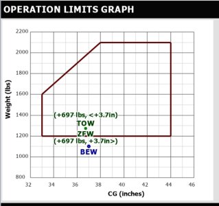

No, because the data you've given hides some of the data that iFly needs to have. Do you have a "typical" W&B chart--maybe from your POH or equivalent--that shows the actual W&B envelope? Something like this? (Your graph may look different, but that doesn't matter.)
