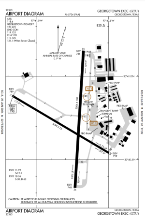

iFly has two ways of showing detailed airport layouts. One is via the published FAA Airport Diagram. However, not all airports get one of those, so if that's not available, iFly shows a "RealView" of the airport, which (I think) is aerial imagery extracted from Google Maps (or something similar).
In this case, KGVL does NOT have a published Airport Diagram. If it did, it would show up here: https://www.faa.gov/air_traffic/fli...ts/dtpp/search/results/?cycle=2401&ident=kgvl
(You can search for other airports on that FAA site to see if they have Airport Diagrams. For example, nearby KLZU does, and iFly shows it too.)

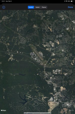

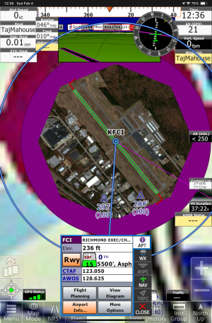

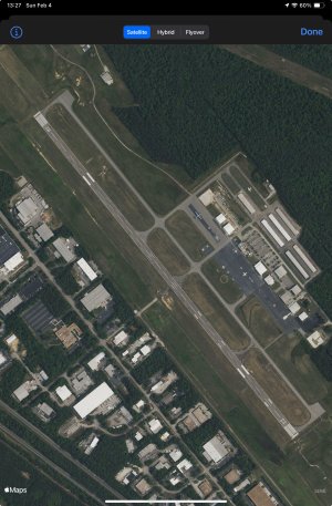

iFly automatically provides an overhead photo of a small airport when you zoom in a bit or fly close to it.
I can zoom in far enough to see a reasonable amount of detail and pan around to see it all:
The important word here is "automatically," and it's directly related to iFly's design philosophy, that tries to make things seem intuitive for the pilot, especially when in flight. That philosophy inevitably leads to compromises--because we all know that this stuff isn't simple at all.
Anyway, iFly does not display those small airport diagrams--or at any rate, it hasn't displayed them to me, and I don't think it it does download them. Here's why:

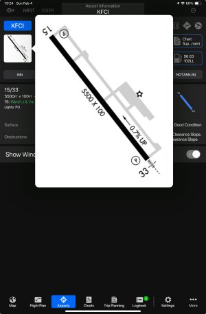

If I tap on a "small" airport I find this, with a "View Diagram" button:
Tap "View Diagram" and see:
KFCI has instrument procedures for both ends of the runway.
And it's the same for all similar "small" airports I've tried. So I have to conclude that iFly doesn't have those diagrams. That appears to confirm denniscormier127's observation.
So I think this is a bug and have filed a bug report from within iFly on my iPad Mini 6.

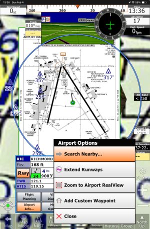

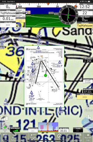

Also, when I zoom iFly in on a "large" airport I automatically see the diagram:
...and I know that it's also possible to see the Realview of the airport, too. I tap on the airport (the green dot here) and then the "More Options" button that appears--to see this menu:
...containing those useful functions, right there, when and where I need them. That seems intuitive, to me.

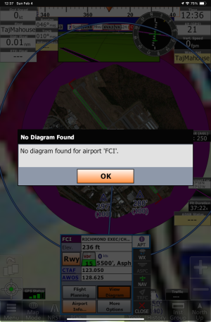

Hah. So I tap "Zoom to Airport RealView" and get...
YOICKS!
I get nuthin'. It ain't nuthin' there. Whut th--?!!!
Well. Not what I expected.
