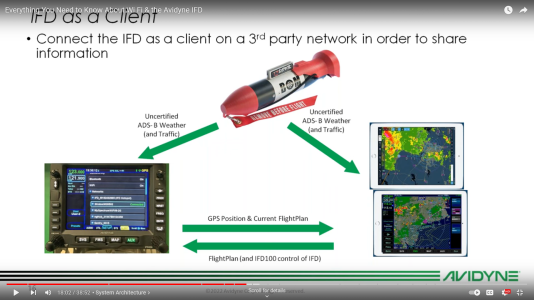

Is anybody using Avidyne and IFly with a third part wireless ADS-B receiver (Stratux, Levis Stratus ect.)?
I'm using Stratux and can't transfer flight plans in either direction.

I see a post on the facebook page from Oct about the same issue
I was not able to get this feature to work on the Dynon until: 1) Disabling any other internet connection (Cell Connection), 2) Specifically selecting the Dynon Device vs auto detect device.
Rewatching Avidyne videos 2 say you can transfer flight plans with the setup I have and 1 says you must be connected to the IFD?
I do get GPS this way (the stratux has no GPS) but not flight plans.
