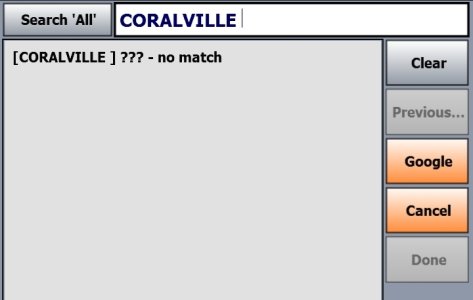

This is what it looks like for me:
@Don Maxwell , I edited the bug description to point out that the "Google" button appears after EITHER tapping "Select 'All' " OR tapping the spacebar in the search field.
However, you also posted this in the other thread:
I don't see any of that behavior in Android or Windows, so if you could post a photo of how you see "part of the Google button" on your iPhone, that might be helpful when AP troubleshoots this.
I can't duplicate it now. But it takes at least 3 characters AND a space to get the Google button.
