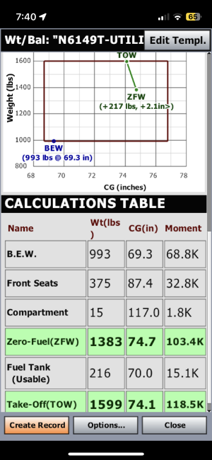

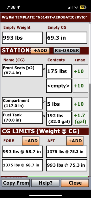

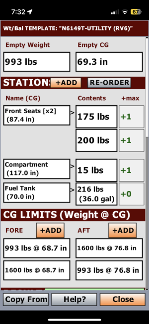

I have two profiles - one for Utility and one for Arrobatic:
Thank you Very Much. Your profiles cleared up a lot of things I didn't understand based on the previous owners entry. Very Very Much Appreciated!!!
