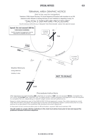

I was trying to locate a Chart Supplement (AF/D) within the software and I'm not sure if it is my lack of knowledge with how the software operates or it simply doesn't exist. For example sometimes the FAA does stupid things like put a departure procedure in the Chart Supplement, i.e. Dalton departure out of TEB, or an airport that has pilot controlled lighting on a different frequency than the CTAF.

Actually I gave a perfect example in my message, the Dalton departure out of TEB, it can only be found in the CS. I also gave the example where the PCL is on a different frequency that the CTAF but I did eventually find that in the info page.
There is a lot of information in the CS that isn't part of the individual airport listings, specifically look at section 3 "Special Notices".
Although I don't often use VORs anymore the CS contains information on VORs, specifically their service volume and any unusable radials.
I apologize for missing that part of your original post. Thank you for posting the photo. Yes, this would be an example of information not available in iFly because it doesn't host the CS "as-printed".
