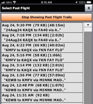

Here is flight trail log for 24Aug24, this was actually only 3 flights. Log shows 8 entries, indicating having to restart the app 5 times!
Always seems to happen after trying to zoom the display.
Tablet is Samsung T380, I have two of them (redundancy), does the same on both.IMG_1860.jpg

Please submit bug reports and manually select the logs corresponding to the shutdown events. Instructions for how to do that are here.
This was a problem seen during beta testing, and Adventure Pilot did a lot of work to stamp out this bug. It was thought to have been eradicated before release to production. Your logs will help AP continue to hunt down the causes of this behavior.
