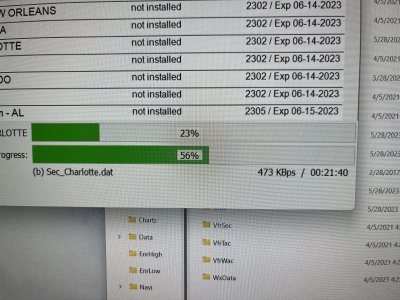

Any way we could see an improvement in download speed? This is one of my better download rates. 32 Minutes to download 5 States (FL, GA, NC, SC, AL)
Before someone says it is your internet. I am sitting in the office (I know it is Sunday, but had a few critical events today) on a dual 10G connection to Verizon's metro backbone. I am connected via a 1G connection to my laptop. I am getting 947 Mbps down hitting Frontier's servers in Dallas, TX. I am accessing from Central FL. IMG_4431.jpg

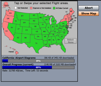

Where do you see the view of the download progress like those in your screenshots. Mine look like this:

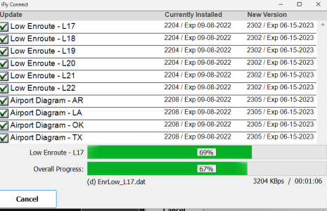

You're using a tablet. Chad and I were using iFly Connect on a Windows machine to update the SD card for a 7xx device.
