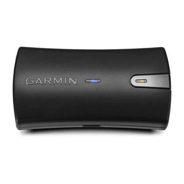

Ditto on what smoke asked... what device are you using to run iFlyEFB and what are you using for your ADS-B in?
I use the original Garmin Glo to feed GPS to any tablet I'm using since the first iPad Mini we had did not have GPS.
Others have recommended a Bad Elf GPS receiver, but I don't know which one.
Many ADS-B receivers also provide GPS location.
The only issues since using the Glo have been the tablets overheating and freezing or dying.
