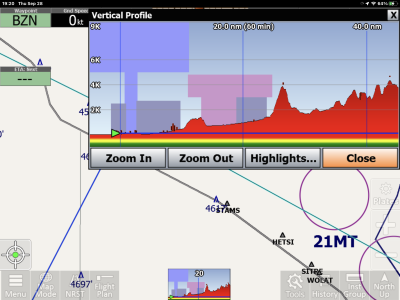

I am trying to figure out all of the color coding through altitudes on the vertical profile. User manual really has nothing. Any other place to reference? Could this be airspace? Thanks

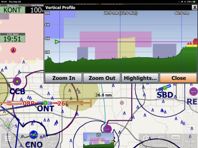

Ok, so I think figured it out. I entered a flight plan from LAX to Ontario and ran it in simulation mode. I was able to see the different airspace, color codes and now understand how to read it. I suspect the yellow/tan areas on vertical profile are the TFRs.

You can also click on one of the colored boxes in the altitude profile, and a pop-up will ask if you want to 'View on Map', then take you right to that point on the map where you can see it and access more info.
