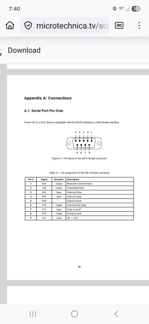

Well I received the SENA SD1000 Bluetooth today. Was hopeing to find some info enclosed to tell me which pin number of the DB9 I could use to get NMEA data output from. No such info. Power for the SD1000 is USB plug and is doable with a USB to 12v module. The baud rate looks straight forward as to the info printed on the device. BUT which pin out can I find NMEA data. Looked at the Sena.net support site and about all that was there was not understandable for me. Anyone found NEMA source output pin # for the SenaSD 1000 BT device that we can use???
Think I may have found the answer. As per the Instal Guide found on Google here's a screen shot. Looks like pin 2 signal out and pin 5 is signal ground. Interesting that pin 9 can be used for 5v to 12v input( assume to be power for BT device) and acceptable to use 12vdc. Screenshot_20250828_194046_Firefox.jpg
Think I may have found the answer. As per the Instal Guide found on Google here's a screen shot. Looks like pin 2 signal out and pin 5 is signal ground. Interesting that pin 9 can be used for 5v to 12v input( assume to be power for BT device) and acceptable to use 12vdc. View attachment 1426
Yes it is pin 2

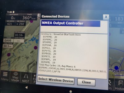

Progress report: powered up BT and X7 . Got to the setup and aligned NMEA data to be output. Appears that data being output. Next step will be to connect the RS232 wire and ground and see if it will feed the GRT.

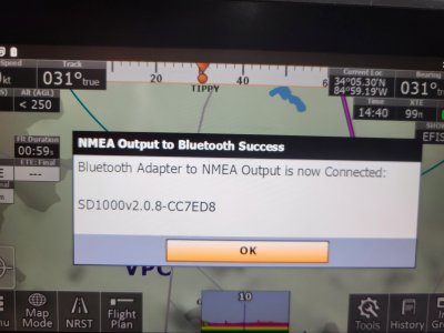

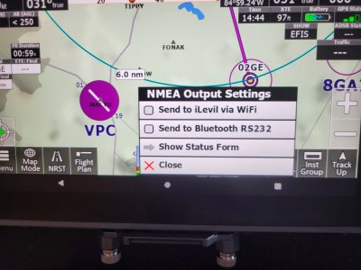

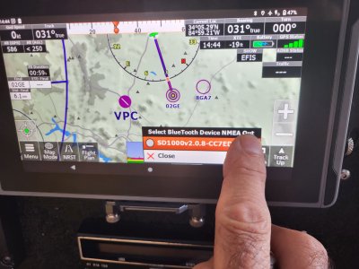

9/ 6/25. Installed in RV7, powered up and appears to be paired with X7. problem with the X7 in that it will not allow me to select the box " Bluetooth RS232." And neither can I select on the next page the device name I have for the BT. So never was able to see any communications on the GRT although it appeared to be paired . Guess this is a question for iFly and the software routing of the comm data to the BT device. About all I can do is verify it's paired, that's indicated by a green LED on the BT that flashes every 1 sec. Here's couple pic of the error messages received.
Later in the day:
Tried couple of different android pads with iFlyefb with the same results. Also the error messages that says not connected to the BToutput adapter will be followed with a message that says it is connected. Will do this with or without power on the BT !

I have been using the iFly BT NMEA out function for close to 200 hours now with my Android tablets and a TrioEZ Pilot with complete success, but with a DSD TECH SH-23A adapter. I have seen the failed BT connection message a few times before, but it only happens when I fail to close out (uncheck) the BT out connection in the set up menu prior to shutting down the iFly after my last flight. I get the exact messages in your last two screen shots. A power down and up of iFly and the BT adapter usually corrects the failure.
I think what causes the failure is that iFly remembers and is trying to connect to a previously closed socket on the adapter. While the last message says connection success the adapter LED blink sequence doesn't agree.

9/7/25. Have success with the SD1000 BT and the GRT. I had used a break out DB9 board and would you know that the pin 5 on that board was open!! The printed circuit route was damaged! Replaced the DB9 and com was established with the GRT. I find that on initial power up that the connection to the BT has to be re-established but that can be done on the iFly menu by re selecting "send BT 232" and re selecting the "device name" then it immediately connects and the red led indicates com established with GRT.

9/13/25 the BT connected X7 made the initial flight today. The AP tracked nicely thru the internal GRT . Was a short flight and no issues with the Track from the X7 to the GRT via SD1000 BT. However there still remains some work to get the BT connected properly... The effort here is to get a single green LED blink once per second. And that requires some button pushing on the X7 while watching the LED on the BT. So the BT has to be visable from the pilots position..... and that has to be done PRIOR to flight. This is Not the pairing of the BT but getting the BT set up to communicate properly. With an active platform up and running maybe we can try some beta revs that will help simplify the buttonology. Let me know.
